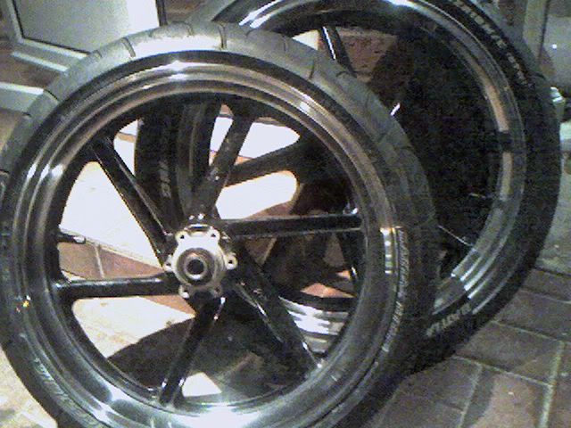

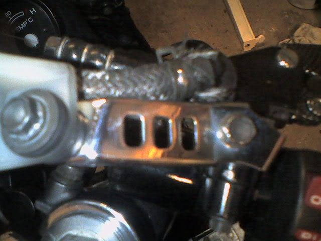

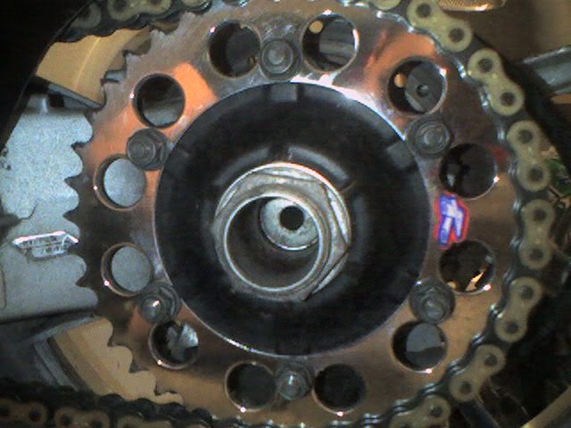

Posted - 07/09/2007 :  13:32:06  Show Profile  Visit viper_biker's Homepage
I polished a few things using this technique. Here's a few pics from the resuts. These were not the finished articles as I did that by hand.

Posted - 07/09/2007 :  14:35:06  Show Profile  Visit Monkey's Homepage
nice!!! good job!
