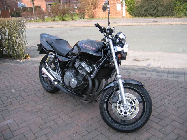

Hi all, new user here. After i got knocked off my Bandit 400 last august, im finally back on 2 wheels with a lovely CB400 which my sister no longer uses. Heres a couple of pics;
http://img.photobucket.com/albums/v489/tob4312/bike3.jpg
http://img.photobucket.com/albums/v489/tob4312/bike2.jpg
http://img.photobucket.com/albums/v489/tob4312/bike1.jpg
Once running, it sounds sweet and rides nice. But, its always reluctant to fire, i have to hold it on the starter for a quite a while before it runs under its own power and then it only runs on three cylinders for a while. If you try to rev it too soon it just dies again. It has brand new plugs, im thinking maybe its a fuelling fault, maybe the carbs need setting up?
Also, it seems down on power. It feels noticeably slower than my old bandit and a super CB400sf version 's' that we have in the family. Surely it should run just the same as the version S, are they not the same engine and power output?! It doesnt seem to come on song until youre at about 10,500rpm, the other we have starts pulling from about 6,000 and just gets stronger at the top end. Mine just feels weak and lacking in grunt below 10,000.
It has one of the kmh-mph mechanical speedo converters fitted so it is no longer restricted, but i hear of others hittng 120mph+ - mine struggles over 100 in 6th, manages about 110 in 4th and 5th. It just feels weak.
Maybe its the fuelling again? Carbs just need sorting out? My only other thought is that exhaust. It looks and sounds lovely, but the center bore of the pipe only looks about 30mm! No idea what exhaust it is, it has a couple of japanese letters on its badge and says 'hand made' under it, and has a 'JMCA' plaque on it.
Any advice would be great - sorry for the essay!

looks like the exhaust is a yoshimura.
