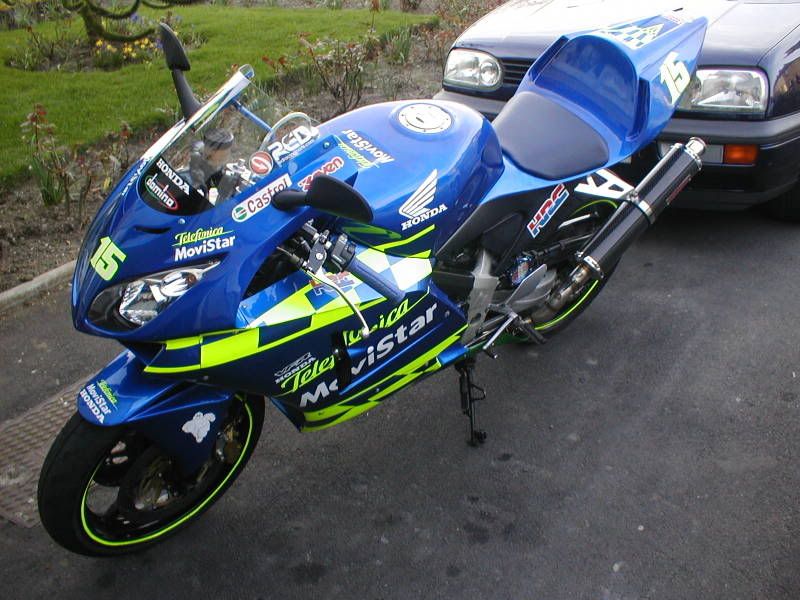

Hi
I have had CBR600rr calipers fitted for a while now and have noticed the brake lines have 'swelled' near the master cylinder (standard cylinder). So I bought new goodridge lines (standard 2x line NC30 ones) as its due for its MOT. I let my mate fit them who is a mechanic... (bad idea)
He has 'bent' the banjo bolt to fit the angle of the caliper which has spilt the lines (Very off) and are useless now (a nice waste of 60 squids).
Anyways does anyone know which lines to fit, e.g size, bonjo angles etc and where to get them from??
Also should I change the master cylinder to a R1, SP1 to compensate for the calipers?
Anthony
89 NC30 RCV 2004 Telefonica Rep - Carbon fibre frame guards, CBR600rr gold calipers, Custom caliper brackets, Goodridge braided hoses, EBC pro-lite front discs, carbon fibre clock surrounds, EMC rear shock, alu clip ons, Polished yoke, fuelcap and breather, custom HRC yoke plug, HRC overflow bottle, *Company Name Removed* full exhaust system
